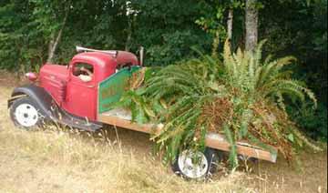

Back to Work!           In order to do the change, the motor had to be set back about a foot, the driveline shortened, the steering lengthened, and the front fenders widened three inches on each side to cover the wider wheel track. He used the wiring harness, steering wheel and column, gauge cluster, and shift tower out of the chip truck. The coolest mod he made (in my opinion) is when he took the power brake hydro-boost off the firewall and mounted it between the rails so the stock 1936 brake pedal operates the stock 1981 hydro-boost. With the 4-cylinder turbo diesel, turbo 400 transmission, power steering, power disc brakes, shocks and a sway bar, this thing sounds like a big rig and corners like a slot car!
           I have done a few things to the truck since I got it back, but mostly I just drive it. I've put a bed on it using the aluminum floor out of the chip truck and so far the paint is just rattle can. I won't paint it until I get phase two done, which is to lengthen the cab 6" through the doors. I have extra doors and an extra cab to help with this project. I am just finishing up the paint on a couple of dragsters in trade for the owner to weld up the cab and doors after I cut them apart. Big job, but it should be cool when we're done.
           That's all for now. It sure was cool to put Rusty back to work with his first job of hauling home those ferns for the yard.
