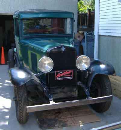

          “Looking’ like a truck!” I can’t think of a better way to start off my update than to quote my buddy Art. It IS starting to look like a truck! All the time put into it is starting to pay off.
          I got the cab pretty much together. I have polished up my reflectors in the headlights and have some seats! When I got it home from Don’s (the guy that got it running), I started in getting the headlights to work. AND I DID! I had one headlight working, then both.
          I still have some work to do to get them to both work all the time but I feel pretty good about getting them to work at all!
