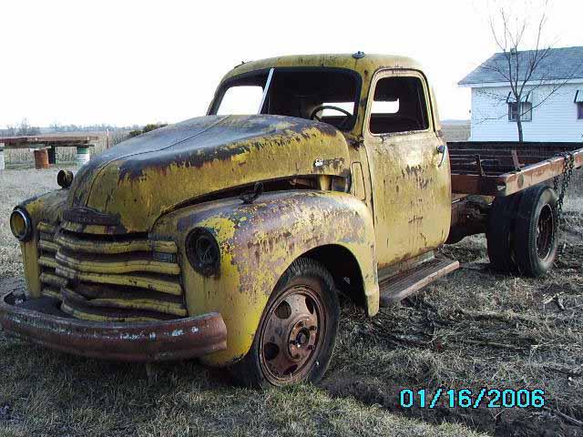

          Hi. I thought I would send you pictures of two of our six 'Bolts.
          The first is a '47 2-ton. We purchased this truck from its original owner's son. It was bought in Nebraska, came to Iowa a couple month later, and stayed there its whole life.
          We currently have this truck down to its frame and are rebuilding it from the ground up. It is in surprisingly fair shape for a farm truck. For some reason, it has the tranny of the Deco style trucks in it. This truck's serial number is 1101. We believe that it is the 100th or 101st one built. This may be why it has that tranny.
          Somewhere it lost its original 235 and was repowered with a 216 (stuck). It also came with a 2 speed, hydo-vac, factory radio and a spotlight. Nice package for hauling cows.
