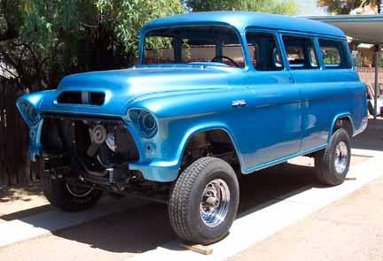

           Hello all. Here is just a note about my finally finishing my 1956 GMC Carryall (or, as some call it, Suburban). It took so long to do this truck partly because GMC original parts are hard to find.

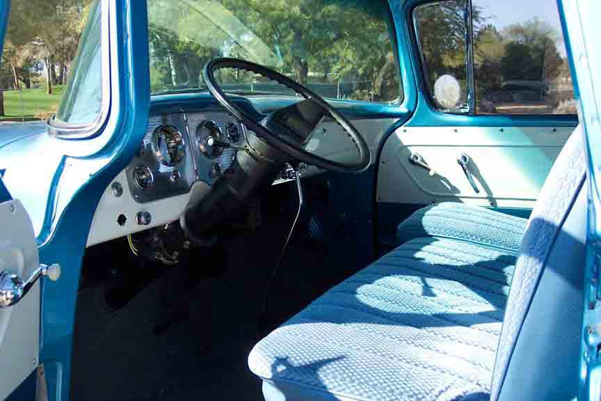

           My project is what is known as a restomod. I made sure the body and interior are close to original. I have all the correct knobs, radio, speaker, lighter, seats, emblems, lights, bumpers, grille and all that. [ Interior pix ]
           The running gear is a newer Chevy 4 x 4. The tilt steering is from the same newer era. As you get older and rounder, it helps to breath while driving. (The seats on these Task Force trucks don't go back far enough!!!)
           I put in a 454 with headers and a TH350 with Nostalgic shifter. I did all the welding / fabrication for the steering box, shocks and so on necessary to fit the modern stuff to the original frame. I also did every window myself including the windshield! That's eleven windows counting the vent windows.

           Here is my 1956 GMC Carryall 4 X 4 conversion "restomod" [ pix ] . She has a 454 Big Block Chevy engine with modern running gear. Right now I'm putting it back together after a body off restoration.
           I have done all the fabrication and fitment myself. I also did some patch repair and drive train installation.
           The truck was in primer up until just a little while ago. I just got her back from the paint job. She's Nassau Blue and white. So, now I'm in the polishing stage -- sure is a LOT of chrome on a GMC!
           My 11 year old Grandson Ryan has helped me. He wants it when I die. I hope I am alive to give it to him. It has taken about six years (off and on) so far.
           Now that I'm retired, I'm gettin' 'er done! She should be ready this fall. And hopefully not running into too many more not-helpful people in the business.
