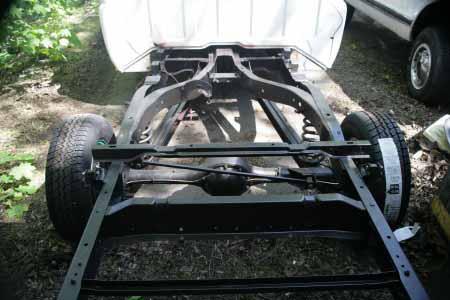

           As you can see, 2005 was the year of the back-end for the truck. I took the bed apart for storage, and then cleaned, primed, and re-painted the rear frame and swing arms. The rear axle was rebuilt, and everything went back together with new bushings. While I was doing the brakes, I replaced the brake lines with stainless steel.
