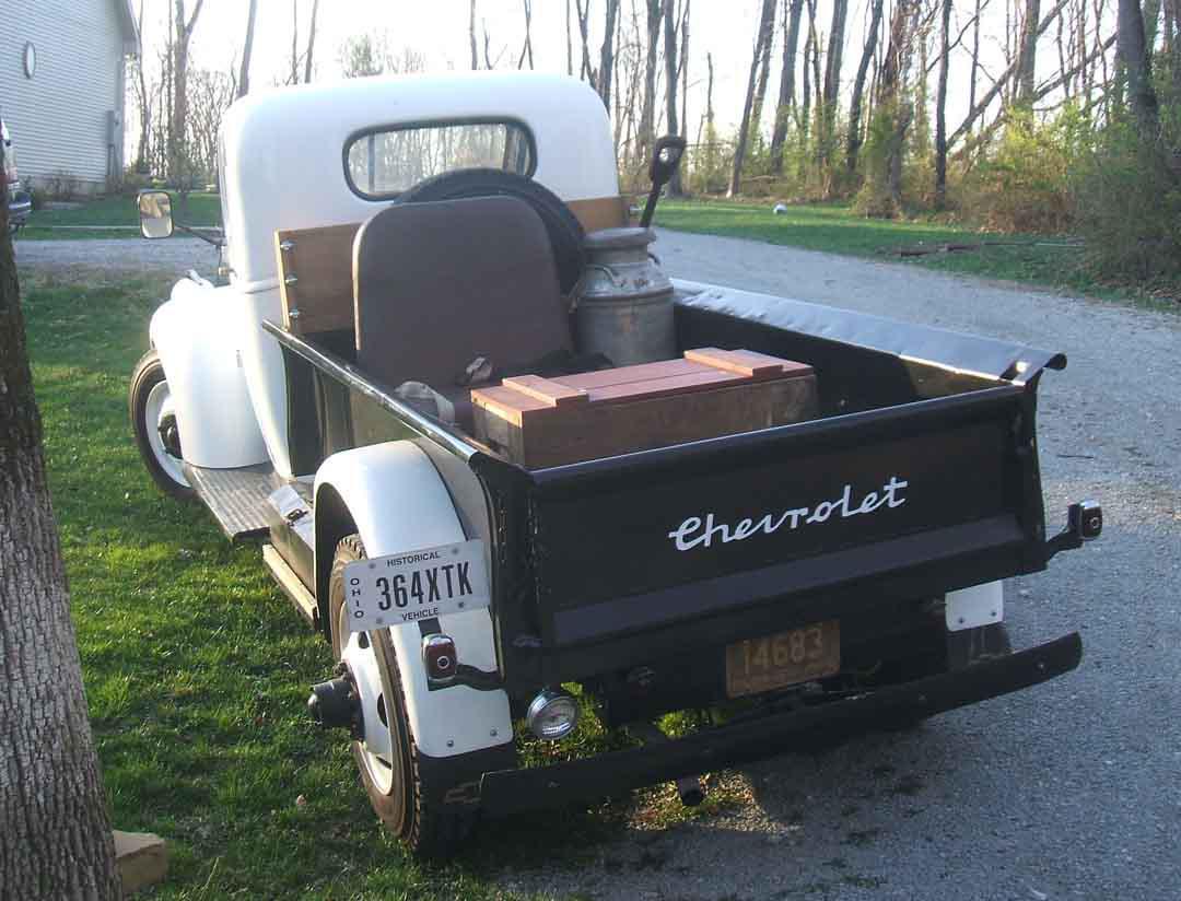

I finished the truck. It is a lot of fun.
This truck, like most of them, did not have a seat in the back bed. In Ohio, it is illegal for children under the age of 16 to ride in the back of an open pickup truck.
A friend of mine found an old seat out of a bus for special needs children. By law, those seats are equipped with seat belts (and they are soft on the bottoms).
So now, two under-age children can ride legally.
Given the amount of metal and glass in the cab and the close proximity to one's face, I believe it would now be safer to ride belted in the back!
I like to think of it now as a very large Subaru Brat.
Also have my "Kentucky Kooler" ice and root beer in a milk can.
Here's a picture of the whole set up. Life is good.
Joe
