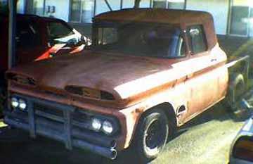

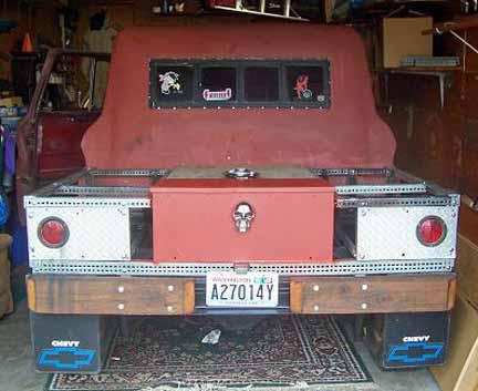

          This is my 1960 Chevy Pick-Up.  It is definitely a One-of-a-kind truck.  It started out its life as a Panel truck. [ front view ]  The body has been cut down and now it is a short frame extended cab. The rear section of the frame has been cut and modified with no changes to the wheelbase.

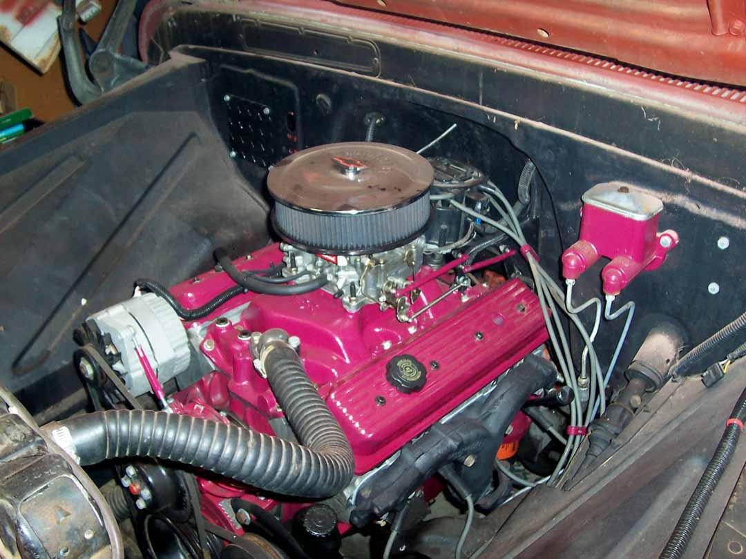

          I bought this truck in California around 1997. Originally it had a 327 motor in it. I took it to Texas for three years, blowing up the 327 in the meantime! I put in a 1979 350 ci which I had taken out of a Chevy Impala. I then took it to Arizona, where I blew up the 350! Then I decided to install a Small Block 350 ci. While I was at it, I added a 2-bolt main, double roller timing chain and a mild R/V cam. It also now has LT-1 aluminum heads, Weiand Stealth manifold and an Edelbrock 750CFM carburetor. [ engine compartment ]
          Some other modifications it has are a 1966 12-bolt rear axle with a four speed granny transmission with a 12" clutch and pressure plate.  The brake system got a new hydraulic clutch and master cylinder.  I also installed power steering out of a later model 1/2-ton Chevy.

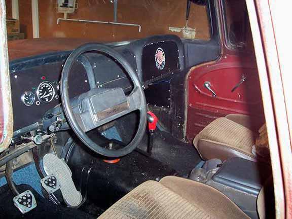

          The interior [ view ] is started with a 1985 Chevy S-10 tilt steering column installed, bucket seats from a Mazda RX-7. I went with a simple dash -- just the speedometer, fuel, and temperature gauges.  It also has a slider back window.
