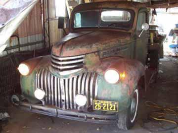

           I thought you might enjoy pic's of my 1941 Chevy 3/4-ton. I have had this truck for close to three years now. I was given this truck by a friend of mine. His Dad bought it 35 years ago with the intentions of restoring it. It sat for all those years and never did a thing to it, It just sat.
           Then they decided it needed to go to the scrap yard! That's when I stepped in and asked if I could buy it. They said, "If you can get it started, you can have it!"
           It took two hours of messing with it and I had it running like a top! Honestly, they thought the engine was bad, as they never heard it run when they bought it 35 years ago!
           They gave me a good title and a matching set of Colorado 1941 plates with it to boot!
           For another year it sat with me tinkering on it now and then!
           The engine is a 216 with no problems, 4 speed, and I believe a factory flatbed with the hard to find corners and back window peep hole. The truck has been totally rewired. A 30 gallon drum was made into a fuel tank as the original tank was rotted away! The truck had 1951 Nash taillights on it when they bought it 35 years ago. I restored them and they look like they belong there!
           I replaced the I-beam front bumper with a bumper off a 1930 Pontiac. I added a 1930-something Dodge bumper on the rear. I am re-doing the interior in black. It has a Dodge mini-van third seat in it! (BTW, that is almost a "bolt in" job and it's a lot more pleasurable to sit on!)
           Next I plan on installing disc brakes in the front and a modern rearend with 3:23 gears or so. This is going to be a daily driver soon! So I want brakes to handle Denver traffic!
           Also in the future, I am going to upgrade the trans to an MC-435. My wife will be able to drive it with an easy shifting tranny. I have a rebuilt 261 waiting for when the 216 gives out.
           And who knows what else in the future? Paint is one of those items that can wait, I think she looks good like it is for now!
