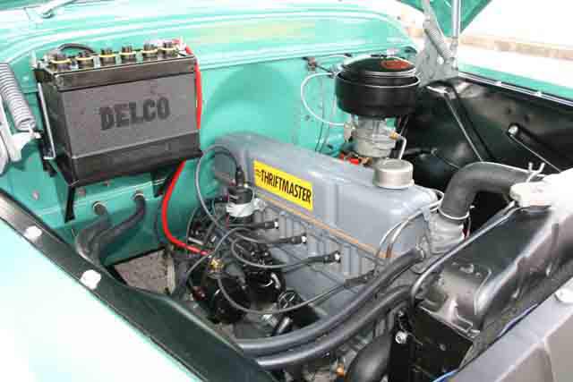

The engine [ pix ] is the original 235 c.i. 6 cylinder which was completely rebuilt. Hardened valve seats were used to allow it to run on today's gas. The engine block has the RPO# for the Heavy Duty 11 inch clutch stamped in it. The transmission is a granny 4-speed.
